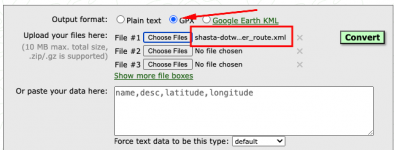

  2. Convert the XML file back to GPX using GPSvisualizer (be sure to select GPX as your output)
  3. Export the new GPX file from GPSvisualizer and load that into Basecamp and your garmin device.
